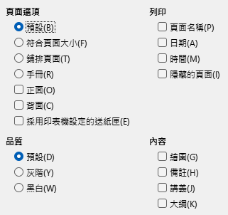

Impress Print Options Dialog
列印
定義頁面邊界上要列印的其他元素。
頁面名稱
Specifies whether to print the page name.
日期
Specifies whether to print the current date.
時間
Specifies whether to print the current time.
隱藏的頁面
Specifies whether to print the pages that are currently hidden from the presentation.
列印品質
See also Printing in Black and White.
預設
Specifies that you want to print in original colors.
灰階
Specifies that you want to print colors as grayscale.
黑白
Specifies that you want to print the document in black and white.
頁面選項
定義列印頁面的其他選項。
預設
Specifies that you do not want to further scale pages when printing.
調整成頁面大小
Specifies whether to scale down objects that are beyond the margins of the current printer, so that they fit on the paper in the printer.
平鋪頁面
指定以並排格式列印頁面。如果頁面或投影片比紙張小,將在一頁紙上列印多個頁面或投影片。
小冊子
Select the Brochure option to print the document in brochure format. You can also decide if you want to print the front, the back or both sides of the brochure.
正面
Select Front to print the front of a brochure.
反面
Select Back to print the back of a brochure.
設定印表機的送紙匣
Determines that the paper tray to be used is the one defined in the printer setup.
