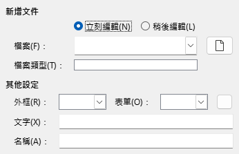

Use the New Document tab from the Hyperlink dialog to set up a hyperlink to a new document and create the new document simultaneously.
若要使用此指令...
Click Hyperlink icon on Standard bar, click New Document.
Hyperlink New Document Dialog Image
新文件
在此區塊中指定新文件的名稱、路徑和類型。
立刻編輯
Specifies that the new document is created and immediately opened for editing.
以後編輯
Specifies that the document is created but it is not immediately opened.
檔案
Enter a URL for the file that you want to open when you click the hyperlink.
選擇路徑
Opens the Select Path dialog, where you can select a path.
檔案類型
Specifies the file type for the new document.
其他的設定
外框
輸入用以開啟連結檔案的外框名稱,或選取清單中預先定義的外框。若將此方塊保留為空白,連結的檔案會以目前的瀏覽器視窗開啟。
格式
動作
文字
名稱
