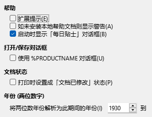

通用
指定 LibreOffice 的通用设置。
要访问此命令...
选择「 - LibreOffice - 常规」。
帮助
指定已安装帮助的行为。
扩展提示
当光标停留在图标、菜单命令或对话框控件上时显示帮助文本。
Warn if local help is not installed
If the offline help is not installed but you are connected to the internet, a dialog will appear offering the option to Read Help Online. Click OK to open your default web browser to the LibreOffice online help pages.
The dialog also includes a link to the built-in help page, which provides instructions for installing the built-in Help.
Show "Tip of the Day" on startup
Displays a small window with a random tip for using LibreOffice. This window appears when you open your first document of the day.
Dialogs
Use LibreOffice open/save dialogs
Select this option to use the Open and Save dialogs supplied with LibreOffice. Deselect to use the standard Open and Save dialogs of the computer operating system.
Use LibreOffice color dialog
Select this option to use the Color Picker dialog supplied with LibreOffice. Deselect to use the standard Color Picker dialog of the computer operating system.
文档状态
打印设置「文档已经修改」状态
指定是否将文档打印算作修改。选中此选项后,当下次关闭文档时,会询问是否保存修改。打印日期将被作为修改输入到文档属性中。
年份 (两位)
定义日期范围,系统将两位数年份识别为此范围内的年份。
In LibreOffice, years are indicated by four digits, so that the difference between 1/1/99 and 1/1/01 is two years. This Year (two digits) setting allows the user to define the years in which two-digit dates are added to 2000. To illustrate, if you specify a date of 1930 or later, the entry "1/1/20" is recognized as 2020-01-01 instead of 1920-01-01.
帮助改进 LibreOffice
Prompt for sending crash reports to The Document Foundation
Asks you whether to send a crash report to help developers improve the software’s reliability. Whenever LibreOffice crashes, you can opt to send a report containing anonymous debugging information, to help track down and eventually fix the root cause.
