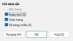

Normally the predefined elements of the master slide are set to visible in the presentation. You can control the visibility of the predefined elements by choosing
