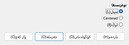

Choose Format - Align
Alignment Dialog
توغرىسىغا
Specifies the type of horizontal alignment for multi-line formulas.
سول
Aligns the selected elements of a formula to the left.

ئوتتۇرىدا
Aligns the elements of a formula to the center.
ئوڭ
Aligns the elements of a formula to the right.
كۆڭۈلدىكى
Click here to save your changes as the default settings for new formulas. A security response will appear before saving.
Save Default Dialog
