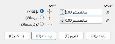

Snap Object Dialog
ئورنى
Sets the position of a selected snap point or line relative to the top left corner of the page.
Note Icon
You can also drag a snap point or snap line to a new position.
Y ئوقى
Enter the amount of space you want between the snap point or line and the left edge of the page.
Y ئوقى
Enter the amount of space you want between the snap point or line and the top edge of the page.
تىپى
Specified the type of snap object you want to insert.
نۇقتا
Inserts a snap point.
بويىغا
Inserts a vertical snap line.
توغرىسىغا
Inserts a horizontal snap line.
