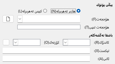

Click Hyperlink icon on Standard bar, click New Document.
يېڭى پۈتۈك
Specifies the name, path and type of the new document in this area.
Edit now
Specifies that the new document is created and immediately opened for editing.
Edit later
Specifies that the document is created but it is not immediately opened.
ھۆججەت
Enter a URL for the file that you want to open when you click the hyperlink.
يول تاللا
Opens the Select Path dialog, where you can select a path.
ھۆججەت تىپى
Specifies the file type for the new document.
باشقا تەڭشەك
كاندۇك
Enter the name of the frame that you want the linked file to open in, or select a predefined frame from the list. If you leave this box blank, the linked file opens in the current browser window.
كۆزنەك
ھادىسە
تېكست
ئاتى
