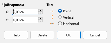

Snap Object Dialog
Ҷойгиршавӣ
Sets the position of a selected snap point or line relative to the top left corner of the page.
Тасвири эзоҳ
You can also drag a snap point or snap line to a new position.
Меҳвари X
Enter the amount of space you want between the snap point or line and the left edge of the page.
Меҳвари Y
Enter the amount of space you want between the snap point or line and the top edge of the page.
Тип
Specified the type of snap object you want to insert.
Нуқта
Inserts a snap point.
Амудӣ
Inserts a vertical snap line.
Уфуқӣ
Inserts a horizontal snap line.
