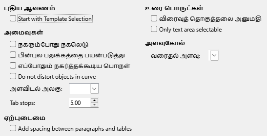

To enable the Presenter Console:
Choose .
In the Display - Presenter console dropdown, select either Full screen or Windowed.
