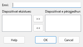

Choose Slide Show - Custom Slide Show and then click New.
Define Custom Slide Show Dialog
Creating a Custom Slide Show
Select a slide and click >> or << to add or remove the slide from the list.
Adds an existing slide to the bottom of the Selected slides list. You need to select a slide in the Existing slides list before you can use this button.
Removes a slide from the Selected slides list. You need to choose a slide in the Selected slides list before you can use this button.
Emri
Displays the name of the custom slide show. If you want, you can enter a new name.
Dy sllajda
Lists all of the slides in the order in which they appear in the current document.
Apliko te sllajdet e selektuara
Lists all of the slides in the custom slide show. If you want, you can change the order of the list by dragging the slides up or down.
