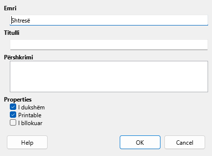

Select a layer, and then choose Format - Layer.
In the Properties area, clear the Visible check box.
Click OK.
In the name tab of the layer, the text color of the name changes to blue.
You can make a layer visible or invisible by clicking on its tab while holding down the Shift key.
Select a hidden layer, and then choose Format - Layer.
In the Properties area, select the Visible check box.
Click OK.
In the Properties area, select the Locked check box.
Click OK.
You cannot edit objects on a locked layer.
Select a locked layer, and then choose Format - Layer.
In the Properties area, clear the Locked check box.
Click OK.
