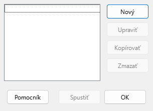

Custom Slide Shows
Defines a custom slide show using slides within the current presentation. You can then pick slides to meet the needs of your audience. You can create as many custom slide shows as you want.
Pre prístup k tomuto príkazu...
Choose Slide Show - Custom Slide Show.
Custom Slide Shows Dialog
Tip Icon
Read the help page Creating a Custom Slide Show to learn more about how to set up your own custom slide shows.
List of custom slide shows
Lists the custom slide shows that are available in the document.
Pre vytvorenie vlastnej prezentácie kliknite na Nová.
Pre spustenie vlastnej prezentácie:
  1. Select a custom slide show from the list.
  2. Kliknite na Spustiť.
Nový
Vytvorí vlastnú prezentáciu.
Upraviť
Add, remove or reorder slides as well as change the name of the selected custom slide show.
Zmazať
Bez nutnosti potvrdenia odstráni vybraný prvok alebo prvky.
Kopírovať
Creates a copy of the selected custom slide show. You can modify the name of the show by clicking Edit.
Spustiť
Runs the selected custom slide show.
Zatvoriť
Closes the dialog and saves all changes.
