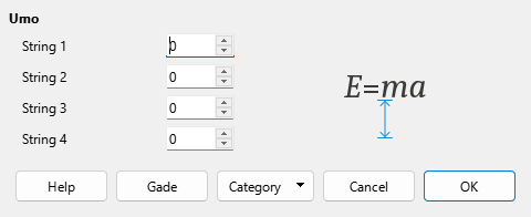

Malaatta
Malaattate foonqe soorramaanote heevishshinni xawisi.
Umi hojja
Defines the height of the symbols in relation to the baseline.
Shiimiidi foonqe wora
Determines the minimum distance between a symbol and variable.

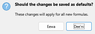

Balaxileelishate bare
Gade
Saves your changes as your default settings for all new formulas. A security response will appear before saving these changes.
Save Default Dialog
