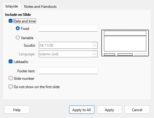

Hasaawa lamu giggishshu qoollanni lai: Isilaade nna Qaagishshubbatenni nna Angateborronni amadubba balaxxe tirantino dargubba ea dandaatto darga.
Gadetenni, Barru nna Yannate buuxote saaxine dandeesantino, kayinni suudishshu qixxisammete qiniino nnaborrote eote saaxine mullichote, ikkinohura isilaadubbate aana barru nna yanna dileellitanno.
Gadetenni, Lekkaallu buuxote saaxine dandeessantino, kayinni borrote eote saaxine mullichote, ikkinohura lekkaallu aana barru nna yanna dileellitanno.
Gadetenni, Isilaadete kiiro buuxote saaxine coisantino, ikkinohura isilaadete kiirra dileellitanno.
Baala isilaadubba aana leella noonsa amadubba ei woy doori.
If you want to change the position and formatting of the master objects, choose View - Master.
You see the master slide with areas near the bottom. You can move the areas , and you can select the fields and apply some formatting. You can also enter some text here which will be shown next to the fields.
Barru darga kisi nna yannate nna barru bare harisi. <date/time> bare doori nna baala isilaadubba aana barru nna yanna suudishsha soorrate boode suudisamme loosaansi. Konni garinni Lekkaalli Dargira nna Isilaadete Kiiro dargira loosanno.
