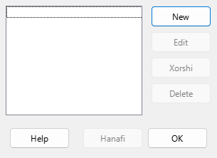

Custom Slide Shows Dialog
Tugote Bido
Read the help page Creating a Custom Slide Show to learn more about how to set up your own custom slide shows.
List of custom slide shows
Lists the custom slide shows that are available in the document.
To create a custom slide show, click New.
To run a custom slide show:
  1. Select a custom slide show from the list.
  2. Click Start.
New
Creates a custom slide show.
Edit
Add, remove or reorder slides as well as change the name of the selected custom slide show.
Huni
Doorantino miila huni woy miila keeniweelo buuxe.
Copy
Creates a copy of the selected custom slide show. You can modify the name of the show by clicking Edit.
Start
Runs the selected custom slide show.
Cufi
Hasaawa cufe baala sooro suuqi.
