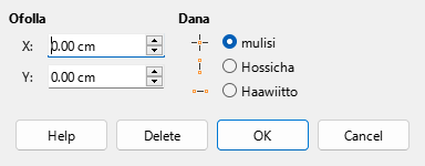

Snap Object Dialog
Position
Sets the position of a selected snap point or line relative to the top left corner of the page.
Qaagishshu Bido
You can also drag a snap point or snap line to a new position.
X axis
Enter the amount of space you want between the snap point or line and the left edge of the page.
Y axis
Enter the amount of space you want between the snap point or line and the top edge of the page.
Type
Specified the type of snap object you want to insert.
Point
Inserts a snap point.
Vertical
Inserts a vertical snap line.
Horizontal
Inserts a horizontal snap line.
