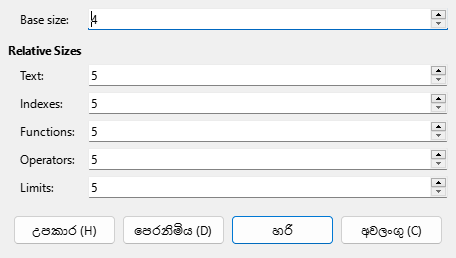

Use this dialog to specify the font sizes for your formula. Select a base size and all elements of the formula will be scaled in relation to this base.

Font Size Dialog
Base size
All elements of a formula are proportionally scaled to the base size. To change the base size, select or type in the desired point (pt) size. You can also use other units of measure or other metrics, which are then automatically converted to points.
Tip Icon
To permanently change the default size (12 pt) used in LibreOffice Math, you must first set the size (for example, 11 pt) and then click the Default button.
Relative Sizes
In this section, you can determine the relative sizes for each type of element with reference to the base size.
āļ´āˇ™āˇ…
Select the size for text in a formula relative to the base size.
Indexes
Select the relative size for the indexes in a formula in proportion to the base size.
āˇāˇŠâ€āļģ⎒āļ­āļē
Select the relative size for names and other function elements in a formula in proportion to the base size.
āļŊāļšāˇ”āļĢ
Select the relative size of the mathematical operators in a formula in proportion to the base size.
Limits
Select the relative size for the limits in a formula in proportion to the base size.
āļ´āˇ™āļģ āļąāˇ’āļ¸āˇ’
Click this button to save your changes as a default for all new formulas. A security response appears before saving any changes.
Save Default Dialog
