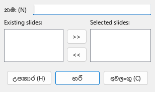

Define Custom Slide Show Dialog
  1. Choose Slide Show - Custom Slide Shows.
  2. Click New and enter a name for your slide show in the Name box.
  3. Under Existing Slides, select the slides to add to your slide show, and click the >> button. Hold down Shift to select a range of consecutive slides, or to select multiple individual slides.
You can change the order of the slides in your custom slide show, by dragging and dropping the slides under Selected Slides.
