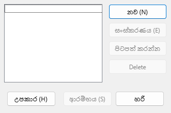

Defines a custom slide show using slides within the current presentation. You can then pick slides to meet the needs of your audience. You can create as many custom slide shows as you want.
To access this command...
Choose Slide Show - Custom Slide Show.
Custom Slide Shows Dialog
Tip Icon
Read the help page Creating a Custom Slide Show to learn more about how to set up your own custom slide shows.
List of custom slide shows
Lists the custom slide shows that are available in the document.
To create a custom slide show, click New.
To run a custom slide show:
  1. Select a custom slide show from the list.
  2. හරික්ලික් කරන්න.
පේළි
Creates a custom slide show.
පිට වීම
Add, remove or reorder slides as well as change the name of the selected custom slide show.
මකන්න
තොරගත් අංගය හෝ අංග මකන්න, ස්ඊර කිරීමකින් තොරව .
පිටපත් කරන්න
Creates a copy of the selected custom slide show. You can modify the name of the show by clicking Edit.
Start
Runs the selected custom slide show.
චසාදමන්න
Closes the dialog and saves all changes.
