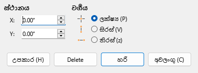

Snap Object Dialog
X ⎃⎊āļŽāˇāļąāļē
Sets the position of a selected snap point or line relative to the top left corner of the page.
Note Icon
You can also drag a snap point or snap line to a new position.
X axis
Enter the amount of space you want between the snap point or line and the left edge of the page.
Y axis
Enter the amount of space you want between the snap point or line and the top edge of the page.
āļ¸āˇāļ¯āˇ’āļŊ⎒āļē
Specified the type of snap object you want to insert.
Point
Inserts a snap point.
āˇƒāˇ’āļģ⎃⎊
Inserts a vertical snap line.
āļ­āˇ’āļģ⎃⎊
Inserts a horizontal snap line.
