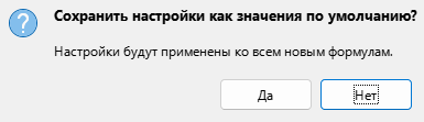

По умолчанию
Saves your changes as your default settings for all new formulas. A security response will appear before saving these changes.
Диалог Сохранить
