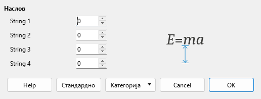

Use this dialog to determine the spacing between formula elements. The spacing is specified as a percentage in relation to the base size defined under Format - Font Size.
Use the Category button to determine the formula element for which you would like to specify the spacing. The appearance of the dialog depends on the selected category. A preview window shows you which spacing is modified through the respective boxes.
