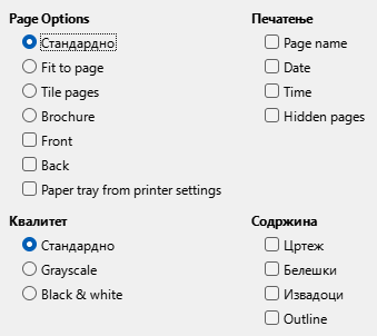

Open a presentation document, choose - LibreOffice Impress/LibreOffice Draw - Print.
Impress Print Options Dialog
Печати
Defines additional elements to be printed on the page margin. You cannot select some elements if you marked Brochure in the Page options area.
Име на страницата
Specifies whether to print the page name.
Датум
Specifies whether to print the current date.
Време
Specifies whether to print the current time.
Скриени страници
Specifies whether to print the pages that are currently hidden from the presentation.
Квалитет
See also Printing in Black and White.
Стандардно
Specifies that you want to print in original colors.
Сиви нијанси
Specifies that you want to print colors as grayscale.
Black & white
Specifies that you want to print the document in black and white.
Опции на страницата
Define additional options for printing the pages.
Стандардно
Specifies that you do not want to further scale pages when printing.
Fit to page
Specifies whether to scale down objects that are beyond the margins of the current printer, so that they fit on the paper in the printer.
Нареди страници
Specifies that pages are to be printed in tiled format. If the pages or slides are smaller than the paper, several pages or slides will be printed on one page of paper.
Брошура
Select the Brochure option to print the document in brochure format. You can also decide if you want to print the front, the back or both sides of the brochure.
Front
Select Front to print the front of a brochure.
Назад
Select Back to print the back of a brochure.
Paper tray from printer settings
Determines that the paper tray to be used is the one defined in the printer setup.
