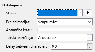

Enhanced Animation Effects Dialog
Skaņa
Select a sound from the Gallery or select one of the special entries.
Sound button
Plays the selected sound file.
After animation
Select a color to be shown after the animation ends, or select another after-effect from the list:
Dim color
Select the dim color.
Teksta animācija
Select the animation mode for the text of the current shape:
Delay between characters
Specifies the percentage of delay between animations of words or letters.
