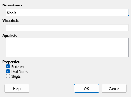

Insert layer dialog

To edit the properties of a layer, double-click a layer tab.

  1. Select a layer, and then choose Format - Layer.
  2. In the Properties area, clear the Visible check box.
  3. Click OK.

  1. Select a hidden layer, and then choose Format - Layer.
  2. In the Properties area, select the Visible check box.
  3. Click OK.
  2. In the Properties area, select the Locked check box.
  3. Click OK.

  1. Select a locked layer, and then choose Format - Layer.
  2. In the Properties area, clear the Locked check box.
  3. Click OK.
