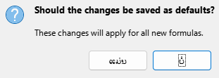

Default
Saves your changes as your default settings for all new formulas. A security response will appear before saving these changes.
Save Default Dialog
