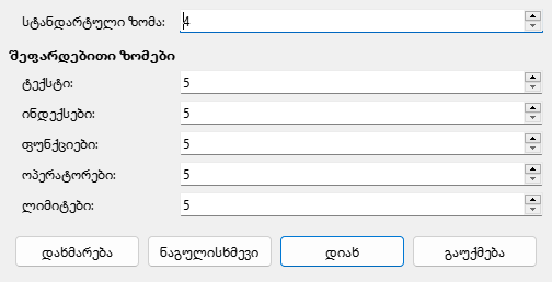

Font Sizes
Use this dialog to specify the font sizes for your formula. Select a base size and all elements of the formula will be scaled in relation to this base.
แƒ‘แƒ แƒซแƒแƒœแƒ”แƒ‘แƒแƒ–แƒ” แƒฌแƒ•แƒ“แƒแƒ›แƒ˜แƒกแƒแƒ—แƒ•แƒ˜แƒก...
แƒแƒ˜แƒ แƒฉแƒ˜แƒ”แƒ— แƒคแƒแƒ แƒ›แƒแƒขแƒ˜ - แƒจแƒ แƒ˜แƒคแƒขแƒ˜แƒก แƒ–แƒแƒ›แƒ
Font Size Dialog
Base size
All elements of a formula are proportionally scaled to the base size. To change the base size, select or type in the desired point (pt) size. You can also use other units of measure or other metrics, which are then automatically converted to points.
แƒ แƒฉแƒ”แƒ•แƒ˜แƒก แƒฎแƒแƒขแƒฃแƒšแƒ
To permanently change the default size (12 pt) used in LibreOffice Math, you must first set the size (for example, 11 pt) and then click the Default button.
Relative Sizes
In this section, you can determine the relative sizes for each type of element with reference to the base size.
แƒขแƒ”แƒฅแƒกแƒขแƒ˜
Select the size for text in a formula relative to the base size.
แƒ˜แƒœแƒ“แƒ”แƒฅแƒกแƒ”แƒ‘แƒ˜
Select the relative size for the indexes in a formula in proportion to the base size.
แƒคแƒฃแƒœแƒฅแƒชแƒ˜แƒ”แƒ‘แƒ˜
Select the relative size for names and other function elements in a formula in proportion to the base size.
แƒแƒžแƒ”แƒ แƒแƒขแƒแƒ แƒ”แƒ‘แƒ˜
Select the relative size of the mathematical operators in a formula in proportion to the base size.
แƒšแƒ˜แƒ›แƒ˜แƒขแƒ˜
Select the relative size for the limits in a formula in proportion to the base size.
แƒกแƒขแƒแƒœแƒ“แƒแƒ แƒขแƒฃแƒšแƒ˜
Click this button to save your changes as a default for all new formulas. A security response appears before saving any changes.
Save Default Dialog
