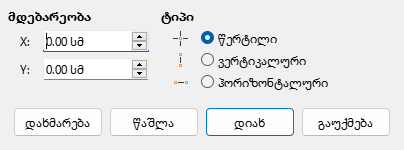

Snap Object Dialog
แƒžแƒแƒ–แƒ˜แƒชแƒ˜แƒ
Sets the position of a selected snap point or line relative to the top left corner of the page.
แƒจแƒ”แƒœแƒ˜แƒจแƒ•แƒœแƒ˜แƒก แƒฎแƒแƒขแƒฃแƒšแƒ
You can also drag a snap point or snap line to a new position.
X axis
Enter the amount of space you want between the snap point or line and the left edge of the page.
Y axis
Enter the amount of space you want between the snap point or line and the top edge of the page.
แƒขแƒ˜แƒžแƒ˜
Specified the type of snap object you want to insert.
แƒฌแƒ”แƒ แƒขแƒ˜แƒšแƒ˜
Inserts a snap point.
แƒ•แƒ”แƒ แƒขแƒ˜แƒ™แƒแƒšแƒฃแƒ แƒ˜
Inserts a vertical snap line.
แƒฐแƒแƒ แƒ˜แƒ–แƒแƒœแƒขแƒแƒšแƒฃแƒ แƒ˜
Inserts a horizontal snap line.
