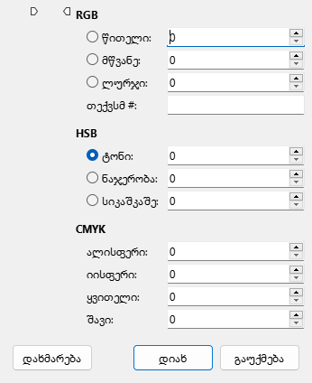

The Pick a Color window
The Pick a Color dialog consists of four main areas.
Click in the big color area on the left to select a new color. Using this selector area you can modify two components of the color as represented in the RGB or HSB color models. Note that these are the two components not selected with the radio buttons on the right side of the dialog.
In the right part of the bottom bar, you will see the original color from the parent tab, Colors.
In the left part of the bottom bar, the current result of your work in this dialog is visible.

RGB
แƒฌแƒ˜แƒ—แƒ”แƒšแƒ˜
Sets the Red component modifiable on the vertical color slider, and the Green and Blue components in the two-dimensional color picker field. Allowed values are 0 to 255.
แƒ›แƒฌแƒ•แƒแƒœแƒ”
Sets the Green component modifiable on the vertical color slider, and the Red and Blue components in the two-dimensional color picker field. Allowed values are 0 to 255.
แƒšแƒฃแƒ แƒฏแƒ˜
Sets the Blue component modifiable on the vertical color slider, and the Green and Red components in the two-dimensional color picker field. Allowed values are 0 to 255.
Hex #
Displays and sets the color value in the RGB color model expressed as a hexadecimal number.
HSB
แƒขแƒแƒœแƒ˜
Sets the Hue component modifiable on the vertical color slider, and the Saturation and Brightness components in the two-dimensional color picker field. Values are expressed in degrees from 0 to 359.
แƒ˜แƒœแƒขแƒ”แƒœแƒกแƒ˜แƒ•แƒแƒ‘แƒ
Sets the Saturation component modifiable on the vertical color slider, and the Hue and Brightness components in the two-dimensional color picker field. Values are expressed in percent (0 to 100).
แƒกแƒ˜แƒ™แƒแƒจแƒ™แƒแƒจแƒ”
Sets the Brightness component modifiable on the vertical color slider, and the Hue and Saturation components in the two-dimensional color picker field. Values are expressed in percent (0 to 100).
CMYK
แƒชแƒ˜แƒแƒœแƒ˜
Set the Cyan color value as expressed in the CMYK color model.
แƒ›แƒแƒ’แƒ”แƒœแƒขแƒ
Set the Magenta color value as expressed in the CMYK color model.
แƒงแƒ•แƒ˜แƒ—แƒ”แƒšแƒ˜
Set the Yellow color value as expressed in the CMYK color model.
แƒ’แƒแƒกแƒแƒฆแƒ”แƒ‘แƒ˜
Set the Black color value or key (black) as expressed in the CMYK color model.
