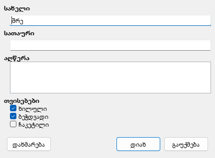

Insert layer dialog
Selecting a layer
To select a layer, click the name tab of the layer at the bottom of the workspace.

To edit the properties of a layer, double-click a layer tab.
