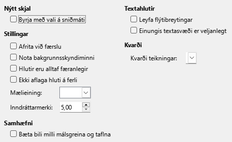

Presenter console activation
To enable the Presenter Console:
Impress General Options Dialog
To activate the Presenter Console:
