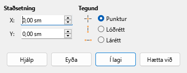

Snap Object Dialog
Staðsetning
Sets the position of a selected snap point or line relative to the top left corner of the page.
Táknmynd fyrir athugasemd
You can also drag a snap point or snap line to a new position.
X-ás
Enter the amount of space you want between the snap point or line and the left edge of the page.
Y ás
Enter the amount of space you want between the snap point or line and the top edge of the page.
Tegund
Specified the type of snap object you want to insert.
Punktur
Inserts a snap point.
Lóðrétt
Inserts a vertical snap line.
Lárétt
Inserts a horizontal snap line.
