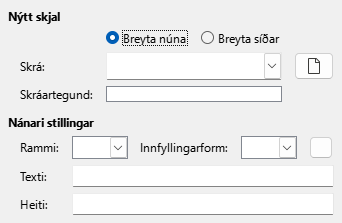

Nýtt skjal
Use the New Document tab from the Hyperlink dialog to set up a hyperlink to a new document and create the new document simultaneously.
Til að nálgast þessa skipun...
Click Hyperlink icon on Standard bar, click New Document.
Hyperlink New Document Dialog Image
Nýtt skjal
Specifies the name, path and type of the new document in this area.
Breyta núna
Specifies that the new document is created and immediately opened for editing.
Breyta síðar
Specifies that the document is created but it is not immediately opened.
Skrá
Enter a URL for the file that you want to open when you click the hyperlink.
Veldu slóð
Opens the Select Path dialog, where you can select a path.
Skráartegund
Specifies the file type for the new document.
Nánari stillingar
Rammi
Enter the name of the frame that you want the linked file to open in, or select a predefined frame from the list. If you leave this box blank, the linked file opens in the current browser window.
Eyðublað
Atburðir
Texti
Nafn
