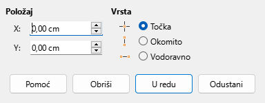

Snap Object Dialog
Položaj
Sets the position of a selected snap point or line relative to the top left corner of the page.
Note Icon
You can also drag a snap point or snap line to a new position.
X os
Enter the amount of space you want between the snap point or line and the left edge of the page.
Y os
Enter the amount of space you want between the snap point or line and the top edge of the page.
Type
Specified the type of snap object you want to insert.
Točka
Inserts a snap point.
Okomito
Inserts a vertical snap line.
Vodoravno
Inserts a horizontal snap line.
