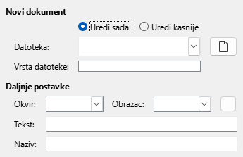

New Document
Use the New Document tab from the Hyperlink dialog to set up a hyperlink to a new document and create the new document simultaneously.
To access this command...
Click Hyperlink icon on Standard bar, click New Document.
Hyperlink New Document Dialog Image
Novi dokument
Specifies the name, path and type of the new document in this area.
Uredi sada
Specifies that the new document is created and immediately opened for editing.
Uredi kasnije
Specifies that the document is created but it is not immediately opened.
Datoteka
Enter a URL for the file that you want to open when you click the hyperlink.
Izaberite putanju
Opens the Select Path dialog, where you can select a path.
Tip datoteke
Specifies the file type for the new document.
Daljnje postavke
Okvir
Enter the name of the frame that you want the linked file to open in, or select a predefined frame from the list. If you leave this box blank, the linked file opens in the current browser window.
