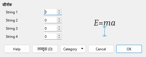

Use this dialog to determine the spacing between formula elements. The spacing is specified as a percentage in relation to the base size defined under Format - Font Size.
To access this command...
Choose Format - Spacing
Spacing Dialog
Use the Category button to determine the formula element for which you would like to specify the spacing. The appearance of the dialog depends on the selected category. A preview window shows you which spacing is modified through the respective boxes.
