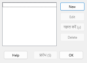

Defines a custom slide show using slides within the current presentation. You can then pick slides to meet the needs of your audience. You can create as many custom slide shows as you want.
To access this command...
Choose Slide Show - Custom Slide Show.
Custom Slide Shows Dialog
Tip Icon
Read the help page Creating a Custom Slide Show to learn more about how to set up your own custom slide shows.
List of custom slide shows
Lists the custom slide shows that are available in the document.
To create a custom slide show, click New.
मनपसंद स्लाइड शो चलाने के लिए:
  1. Select a custom slide show from the list.
  2. Click Start.
New
Creates a custom slide show.
बाहर
Add, remove or reorder slides as well as change the name of the selected custom slide show.
मिटाएँ
Deletes the selected element or elements without requiring confirmation.
नक़ल
Creates a copy of the selected custom slide show. You can modify the name of the show by clicking Edit.
Start
Runs the selected custom slide show.
बंद करें
Closes the dialog and saves all changes.
