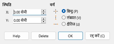

Snap Object Dialog
स्थिति
Sets the position of a selected snap point or line relative to the top left corner of the page.
Note Icon
You can also drag a snap point or snap line to a new position.
X axis
Enter the amount of space you want between the snap point or line and the left edge of the page.
Y axis
Enter the amount of space you want between the snap point or line and the top edge of the page.
क़िस्म
जिस स्नेप वस्तु को आप प्रविष्ट करना चाहते हैं उसे निर्दिष्ट करें.
बिंदु
Inserts a snap point.
खड़ा
Inserts a vertical snap line.
आड़ा
Inserts a horizontal snap line.
