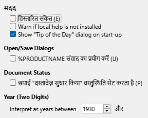

Extended tips
Displays a help text when you rest the cursor on an icon, a menu command, or a control on a dialog.
Warn if local help is not installed
If the offline help is not installed but you are connected to the internet, a dialog will appear offering the option to Read Help Online. Click OK to open your default web browser to the LibreOffice online help pages.
The dialog also includes a link to the built-in help page, which provides instructions for installing the built-in Help.
Show "Tip of the Day" on startup
Displays a small window with a random tip for using LibreOffice. This window appears when you open your first document of the day.
Dialogs
Use LibreOffice open/save dialogs
Select this option to use the Open and Save dialogs supplied with LibreOffice. Deselect to use the standard Open and Save dialogs of the computer operating system.
Use LibreOffice color dialog
Select this option to use the Color Picker dialog supplied with LibreOffice. Deselect to use the standard Color Picker dialog of the computer operating system.
दस्तावेज़ स्थिति
छापने पर "दस्तावेज़ परिवर्धित" स्थिति सेट करता है
Specifies whether the printing of the document counts as a modification. When this option is marked, the very next time the document is closed you are asked if the changes should be saved. The print date is then entered in the document properties as a change.
वर्ष (दो अंक में)
Defines a date range, within which the system recognizes a two-digit year.
In LibreOffice, years are indicated by four digits, so that the difference between 1/1/99 and 1/1/01 is two years. This Year (two digits) setting allows the user to define the years in which two-digit dates are added to 2000. To illustrate, if you specify a date of 1930 or later, the entry "1/1/20" is recognized as 2020-01-01 instead of 1920-01-01.
