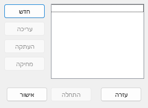

To start a custom slide show:
Custom Slide Shows Dialog
  1. Choose \<emph\>Slide Show - Custom Slide Show\</emph\>.
  2. Select the show you want to start from the list.
  3. Click \<emph\>Start\</emph\>.
