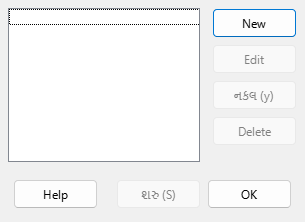

To start a custom slide show:
Custom Slide Shows Dialog
  1. Choose Slide Show - Custom Slide Show.
  2. Select the show you want to start from the list.
  3. Click Start.
