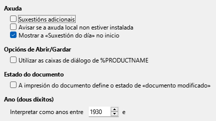

Xeral
Especifica a configuración xeral de LibreOffice.
Para acceder a esta orde...
Escolla - LibreOffice - Xeral.
Axuda
Especifica o comportamento da axuda instalada.
Suxestións adicionais
Mostra un texto de axuda ao pousar o apuntador sobre unha icona, un menú de ordes ou un control dunha caixa de diálogo.
Warn if local help is not installed
If the offline help is not installed but you are connected to the internet, a dialog will appear offering the option to Read Help Online. Click OK to open your default web browser to the LibreOffice online help pages.
The dialog also includes a link to the built-in help page, which provides instructions for installing the built-in Help.
Show "Tip of the Day" on startup
Displays a small window with a random tip for using LibreOffice. This window appears when you open your first document of the day.
Dialogs
Use LibreOffice open/save dialogs
Select this option to use the Open and Save dialogs supplied with LibreOffice. Deselect to use the standard Open and Save dialogs of the computer operating system.
Use LibreOffice color dialog
Select this option to use the Color Picker dialog supplied with LibreOffice. Deselect to use the standard Color Picker dialog of the computer operating system.
Estado do documento
A impresión define o estado do "documento modificado"
Especifica se a impresión do documento conta como modificación. Se marca esta opción, a próxima vez que peche o documento preguntaráselle se desexa gardar os cambios e a data da impresión introdúcese como cambio nas propiedades do documento.
Ano (dous díxitos)
Define un intervalo de data, dentro do cal o sistema recoñece anos de dous díxitos.
In LibreOffice, years are indicated by four digits, so that the difference between 1/1/99 and 1/1/01 is two years. This Year (two digits) setting allows the user to define the years in which two-digit dates are added to 2000. To illustrate, if you specify a date of 1930 or later, the entry "1/1/20" is recognized as 2020-01-01 instead of 1920-01-01.
Help Improve LibreOffice
Prompt for sending crash reports to The Document Foundation
Asks you whether to send a crash report to help developers improve the software’s reliability. Whenever LibreOffice crashes, you can opt to send a report containing anonymous debugging information, to help track down and eventually fix the root cause.
