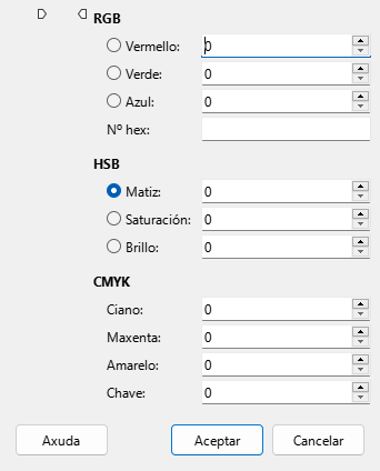

The Pick a Color dialog consists of four main areas.
The radio buttons select the color component of the color. This color component can be expressed in either RGB (Red, Green, Blue) or HSB (Hue, Saturation, Brightness) color models. The CMYK color model is not selectable and is provided only to ease the input of color values using CMYK notation.
The spin buttons are for entering the numerical value of the color component.
With the vertical color component slider you can modify the value of each component of the color. With the large colored square you can select the color component approximately.
The horizontal bottom color bar shows the current color and the new color, side by side.

Sets the Red component modifiable on the vertical color slider, and the Green and Blue components in the two-dimensional color picker field. Allowed values are 0 to 255.
Sets the Green component modifiable on the vertical color slider, and the Red and Blue components in the two-dimensional color picker field. Allowed values are 0 to 255.
Sets the Blue component modifiable on the vertical color slider, and the Green and Red components in the two-dimensional color picker field. Allowed values are 0 to 255.
Displays and sets the color value in the RGB color model expressed as a hexadecimal number.
Sets the Hue component modifiable on the vertical color slider, and the Saturation and Brightness components in the two-dimensional color picker field. Values are expressed in degrees from 0 to 359.
Sets the Saturation component modifiable on the vertical color slider, and the Hue and Brightness components in the two-dimensional color picker field. Values are expressed in percent (0 to 100).
Sets the Brightness component modifiable on the vertical color slider, and the Hue and Saturation components in the two-dimensional color picker field. Values are expressed in percent (0 to 100).
Set the Cyan color value as expressed in the CMYK color model.
Set the Magenta color value as expressed in the CMYK color model.
Set the Yellow color value as expressed in the CMYK color model.
Set the Black color value or key (black) as expressed in the CMYK color model.
