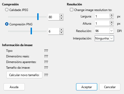

Diálogo de compresión de imaxes
Compression
JPEG Quality
Use the slider to adjust the level of quality of the JPEG compression, from 0 to 100. A value of 100 means no quality loss and a value of 0 may result in a very poor image. The default value of 90 produces very good results and significant image data size reduction.
Icona Nota
The compression values are not standardized between different JPEG image compression software.
PNG Compression
Since PNG compression is lossless, the main reason to use a compression factor less than 9 is when there is absolute need to reduce the size of the document when saving in a slow computer. The uncompress operation does not depend on the compression level.
Resolución
Change image resolution
Check to change the dimensions of the compressed image.
Width, Height
Use the spin buttons to set the new width and height of the compressed image.
Resolución
Select the pixel density (dot per inch - DPI) of the image from the dropdown list.
Interpolación
Select the algorithm to calculate the interpolated pixels.
Image Information
Calculate New Size
Click to calculate the size of the image data, based on the settings of the dialog box.
