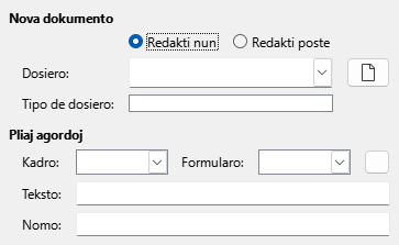

Alklaku al bildsimbolo Hiperligilo en la breto Normala, alklaku al Nova dokumento.
Bildo de dialogo por Hiperligo en Nova dokumento
Nova dokumento
Specifies the name, path and type of the new document in this area.
Redakti nun
Specifies that the new document is created and immediately opened for editing.
Redakti poste
Specifies that the document is created but it is not immediately opened.
Dosiero
Enter a URL for the file that you want to open when you click the hyperlink.
Elekti vojprefikson
Opens the Select Path dialog, where you can select a path.
Dosiertipo
Specifies the file type for the new document.
Pliaj agordoj
Kadro
Enter the name of the frame that you want the linked file to open in, or select a predefined frame from the list. If you leave this box blank, the linked file opens in the current browser window.
Formularo
Eventoj
Teksto
Nomo
