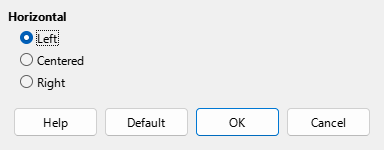

Choose Format - Align
Alignment Dialog
Horizontal
Specifies the type of horizontal alignment for multi-line formulae.
Left
Aligns the selected elements of a formula to the left.
Tip Icon
Text is always aligned left.
Centred
Aligns the elements of a formula to the centre.
Right
Aligns the elements of a formula to the right.
Default
Click here to save your changes as the default settings for new formulae. A security response will appear before saving.
