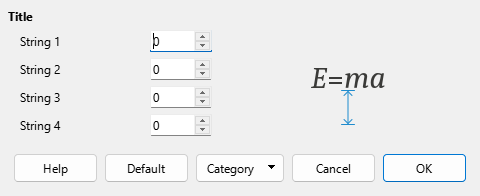

Choose Format - Spacing
Spacing Dialog
Use the Category button to determine the formula element for which you would like to specify the spacing. The appearance of the dialogue depends on the selected category. A preview window shows you which spacing is modified through the respective boxes.
Category
This button allows you to select the category for which you would like to change the spacing.
