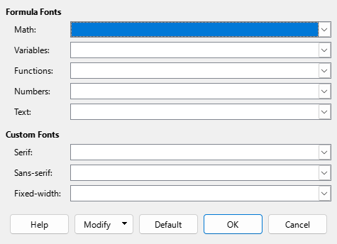

Font Type Dialog
Formula Fonts
You can define fonts for the variables, functions, numbers and inserted text that form the elements of your formula.
The list boxes in the Fonts dialogue display a default font for all elements. To change to a different font, click Modify, then select the element type. A new dialogue box appears. Select the desired font and check any desired attributes, then click OK. To set the changes as the default fonts, click the Default button.

Custom Fonts
In this section of the Fonts dialogue you can define fonts, with which you can format other text components in the formula. The three basic fonts Serif, Sans and Fixed are available. You can add any other font to each standard installed basic font. Every font installed on your system is available for you to use. Select the Modify button to expand the selection offered in the list box.
These custom fonts are used if you set a different font with the FONT command in the Commands window.

Modify
Click one of the choices from this pop-up menu to access the Fonts dialogue, where you can define the font and attributes for the respective formula and for custom fonts.
Default
Click this button to save your changes as the default for all new formulae. After confirming the changes, click the Yes button.
