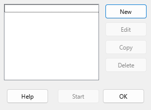

Choose Slide Show - Custom Slide Shows.
Click New and enter a name for your slide show in the Name box.
Under Existing Slides, select the slides to add to your slide show, and click the button. Hold down Shift to select a range of consecutive slides, or CommandCtrl to select multiple individual slides.
You can change the order of the slides in your custom slide show, by dragging and dropping the slides under Selected Slides.
Choose Slide Show - Custom Slide Show.
Select the show you want to start from the list.
Click Start.
If you want the selected custom slide show to start when you click the Slide Show icon on the Presentation toolbar, or when you press F5, select Use Custom Slide Show.
