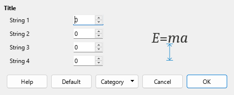

Use this dialogue box to determine the spacing between formula elements. The spacing is specified as a percentage in relation to the base size defined under Format - Font Size.
To access this command...
Choose Format - Spacing
Spacing Dialogue Box
Use the Category button to determine the formula element for which you would like to specify the spacing. The appearance of the dialogue box depends on the selected category. A preview window shows you which spacing is modified through the respective boxes.
Category
This button allows you to select the category for which you would like to change the spacing.

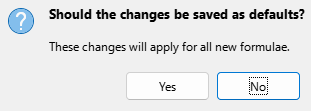

Default
Saves your changes as your default settings for all new formulas. A security response will appear before saving these changes.
Save Default Dialogue Box
